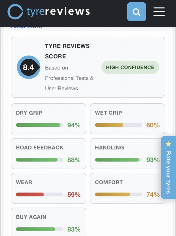

на каква база са тия данни

So when you see a tyre ranked highly for "wet grip" on Tyre Reviews, it's usually the result of a combination of:
= Wet braking performance
= Wet handling lap times
= Aquaplaning resistance
= Driver-assessed wet behaviour
rather than a single measurement. In many of their comparison tests, wet braking and wet handling carry the largest weight within the wet-performance category.
